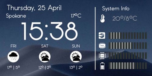

hello all, hey edited many widgets on here that have had issues that went unnoticed when published. One of them I find Austin is when you click the imperial or metric setting when tapping the widget it doesn't change from Celsius to Fahrenheit or vice versa but you can go in and edit the widget but I'm not sure what to select on the pop-up regarding weather to fix so it's always Fahrenheit instead of Celsius. I can see the code and then I can scroll down the list of pop-up items and select farenheit but it just adds another line of code but it doesn't exactly tell you what to remove or change in the existing code which results in nothing being changed or the weather not working at all and only being two symbols that represent degrees because the coating is. This has stumped me like crazy LOL. I did a search and found pretty much nothing on the topic so if someone could chimed in and just tell me how to edit the code for celcius to farenheit I would be grateful. I tried to just add an capital F before the degree symbol in the current code on both the high and low temps and save it but that did not work all I saw were 2° symbols after saving the widget. Thank you very much.
Faslane
here's one of the current codes...under bind core for one of the days
${highTemp4}° | ${lowTemp4}°. Just want to add the Farenheit tag but where please?
File comment: For instance the high and low temps in this Aurora Widget are celcius, there's a menu item to select imperial or metric neither does anything so I want to edit it manually and make it work in farenheit but not sure where to add the tag to the current high and low code.

PostPosted: April 25th, 2019, 2:48 pm
Hello Faslane,
You can change the temp to C><F with many ways. The option works fine. You need to check your particular design/widget because something is missing and the imperial or metric setting doesn't work. You can change it:
1. From the right click built-in option caption>Metric/Imperial units - onclick>!SwitchUnit
2. Using any clickon option with this tagcode "!SwitchUnit" directly on a widget assigning it to image,txt,button etc
3. Using js code:
accweathercore1.cmd(null,"!SetCelcius")
accweathercore1.cmd(null,"!SetFahrenhite")
accweathercore1.cmd(null,"!SwitchUnit")
For example using a button:
Code:
function button1OnClick(Sender)
If you still can't figure out how to do it, attach the .xwp and I check it for you. With all the above you'll not have problems... :)

PostPosted: April 25th, 2019, 3:09 pm
Sorry Faslane because I still don't understand what you want to do. I perfectly know how the widget works because I made it.. :)
There is NO clickon option or any hotspot used for "clickon" function.
Questions:
1.You're talking about pc or Android?
Because in this section is for the pc widgets...
If you're talking about Android I need to check the Android version..
2.You want to create a hotspot to directly change the unit or the "right click" option doesn't work for you..
Ok I think I found it. Seems that I forgot to assign the tag there..
Give me 5 mins to fix and re-upload it to the Android gallery...
PostPosted: April 25th, 2019, 3:17 pm
Ok fixed! Thank you for let me know. The amount of the widgets is big and errors can happen during the port to Android.
I have already overwrite the widget. Please download again from the online gallery! I suggest you to remove the not working widget first. Tell me if it's ok now..
