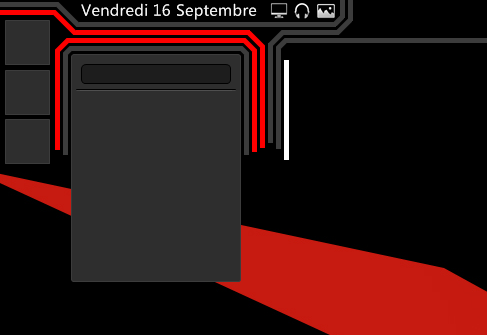

ok and do you have a simple code for the same effect ?
My projet

 Post subject: Re: Slider Widget ?
PostPosted: September 16th, 2016, 11:45 am
Hmm.. You can use some 'tricks' using slidepanels and layers that don't need special js. So when you click on a button a slidepanel will open and the rest will close etc.
A javascript works when you have the right components in place. So depends also on this. I'm sorry but this period I'm busy to create something similar and send you a demo. You need to make some tests by yourself

I try with slidepanel but I can not seem to have more or the same effect
PostPosted: September 16th, 2016, 12:20 pm
Remember that IN the sidepanel you can put anything you want that will follow the movement. Only needs some tricky moves
