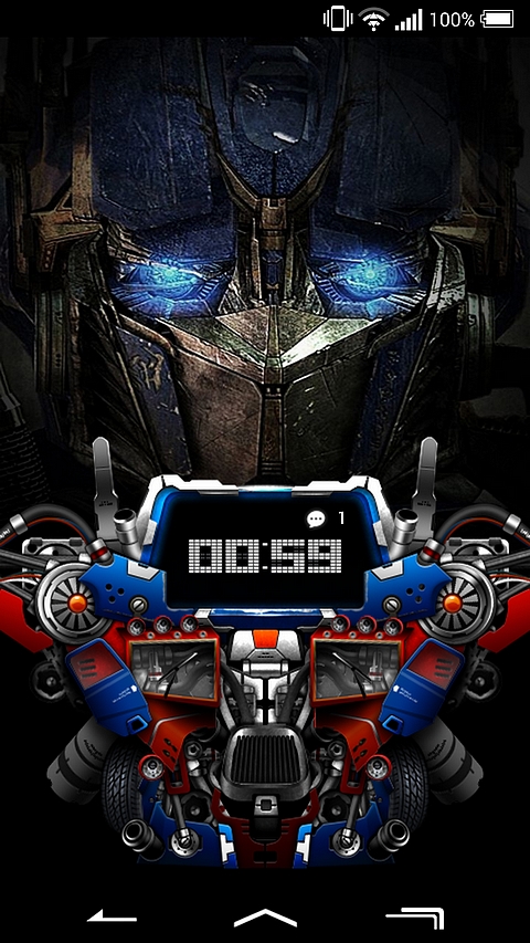

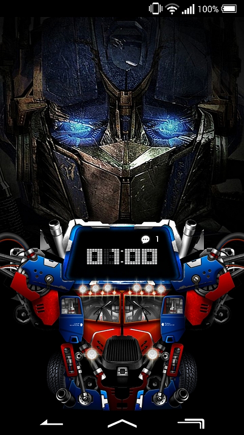

It calls "Optimus Robot Clock", an idea from an Android lockscreen theme and will work like this:
BEFORE and AFTER the double click:
If you want I can send you the .xwp to check it..

for the correct position of eyes, look at this:
also you can find more by searching for it

 Post subject: Re: Rotate Object?
PostPosted: September 11th, 2014, 7:58 am
I have already checked mate!!! But maybe you need to notice that in my design there is NO head like the original! :lol:
Only the body. So I had to "create" a custom position of the eyes...
...and if you check closer, my position of the lights are more similar to the original.. Trust me! ;)

You will notice that the "eyes" are now the Optimus core light and many more..... ! :D
optimus_robot_clock.xwp [1.74 MiB]
Downloaded 591 times
