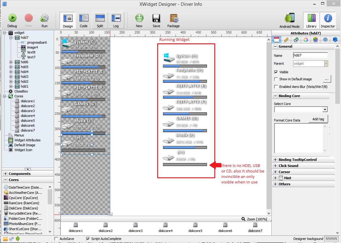

i have to rebuild an old win 7 Gadget with Xwidget called sushi's drive info
http://ftparmy.com/images/drive-info-gadget-01.jpg
the basic functions I have, hard drive info, progressbar and other widget works well so far. Now I would like that not available disks are not displayed,
also the drive will only appear when I plugin a USB stick, external HDD or put a CD in the CD Rom.
Something like "show Only When Plugged"
The basic framework consists of HDD layer for each drive letter one.
https://www.dropbox.com/s/eafcadxfettt94w/widget.JPG?dl=0
can someone help me out here
sorry for my bad english

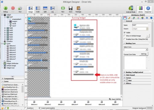

Hello,
thank you for your help.
i have do all the things, i will bind each letter from a -z to a core.
also it should be invincible an only visible when in use
watch image plz
can you help me with the script
thanks

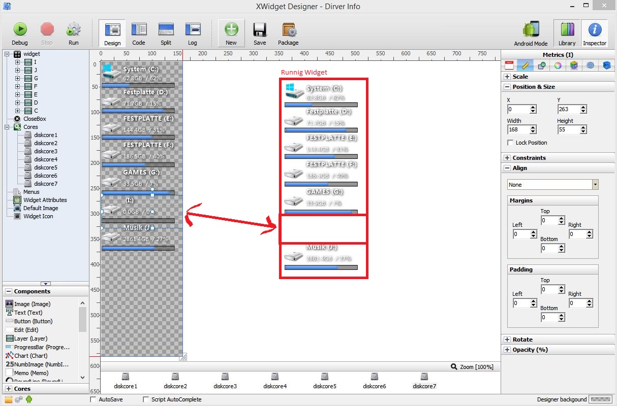

Hi,
Ok the Script is working Perfect thank you.
But now i have a hole in the Widget. Is there an Auto position for each Layer
Thanks

PostPosted: September 8th, 2014, 10:10 am
Posts: 362
as i said here:
Quote:
for Aligning and Positioning:
you should use Aligning to reposition the Visible Objects,
current Aligning Feature of Xwidget seems a little buggy to me,
so you can write script code to do this if needed
there is an option named [Aligning] available but seems buggy to me,
you can find it here:
1. select an object
2. on the Right-Sidebar (Inspector) goto 2nd tab (Metrics)
3. there is an option named [Align]
you can change between different Aligning Options,
since i don't use it so much, i don't know exactly which one will work for you, and if it work correctly,
but i think the [Top] or [MostTop] can be used for this,
try it first,
and if it doesn't work correctly, you can write script code to do the repositioning of objects
