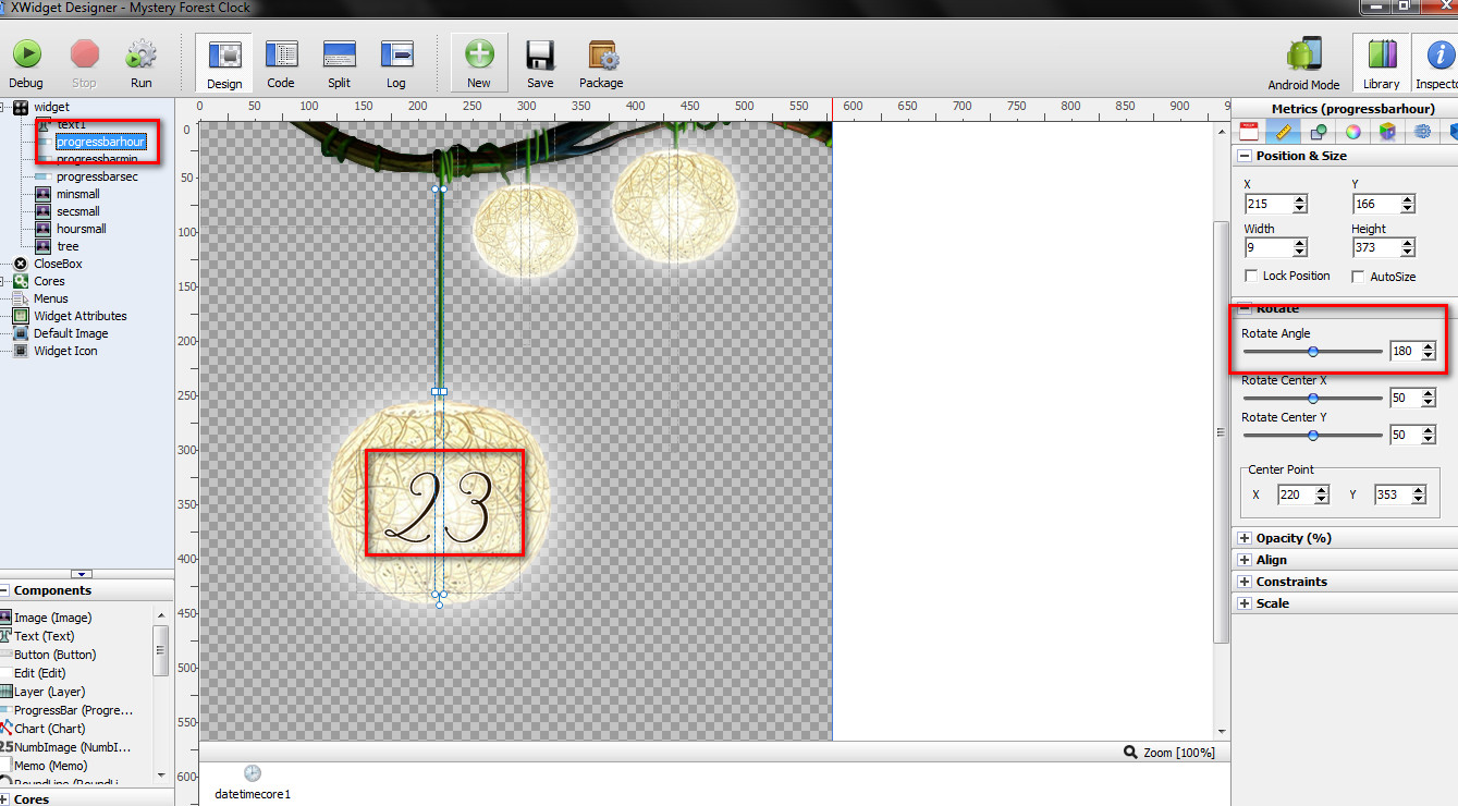

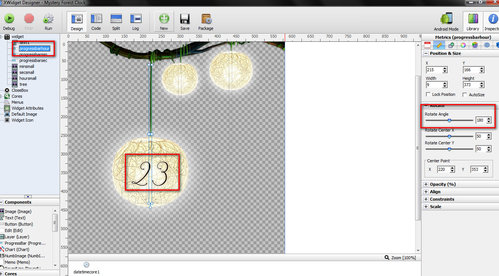

Ok I figure out but I need a little "trick". The progress bar that I use is rotated 180o because I want the zero value starts from up.
So the txt using this:
"text1.top = progressbar1.thumb.top+39;"
has opposite movement..

PostPosted: May 3rd, 2014, 11:07 am
Posts: 362
how about this:
Code:
text1.top = progressbar1.Height-progressbar1.thumb.top+10;
note:
change the number to adjust to your design
PostPosted: May 3rd, 2014, 11:09 am
Works great!! :D
Thanks a lot mate!
