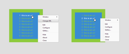

Hi,
I would like to create a widget which has (among others) a list with several url links. If right clicking at a link of the list a menuitem "Change URL" should appear. But "Change URL" should only appear within a special area - the blue area in my example, "Change URL" should not appear when right clicking at the green area. It works fine with the first entry of the list but not with the others. Is it possible to achieve this for all entries of the list without an additional menuitem "Change URL" for every entry in the list? Thanks in advance! :)

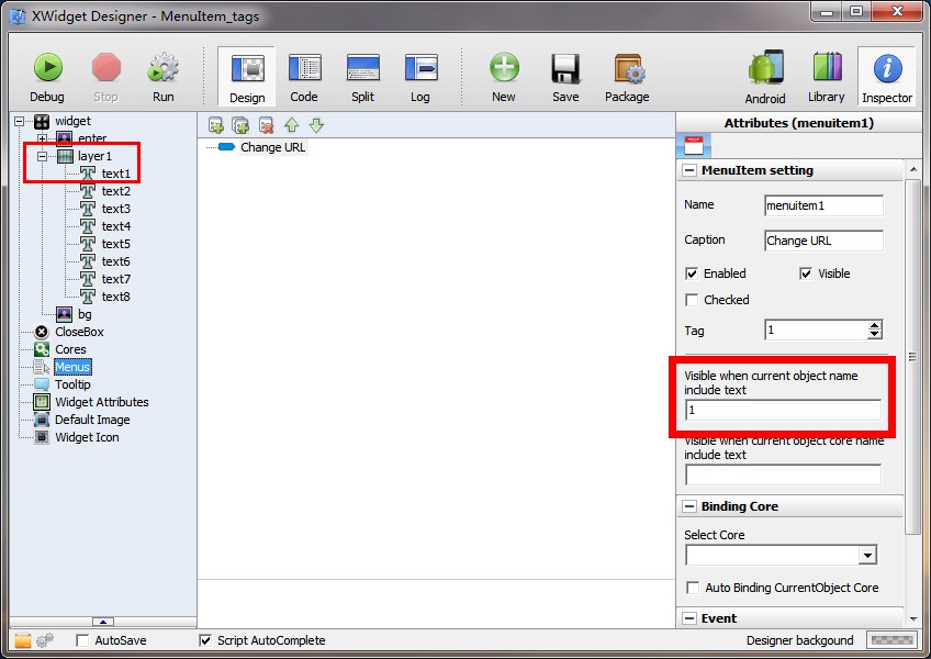

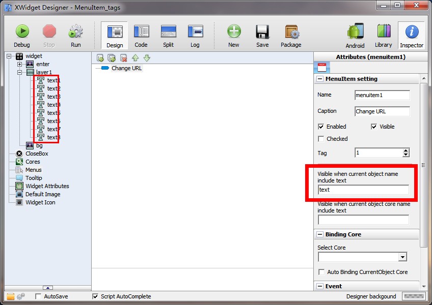

you should set it as below:
wrong setting:
PostPosted: May 14th, 2013, 8:33 am
Posts: 112
Thank you very much! It works fine now! :D
