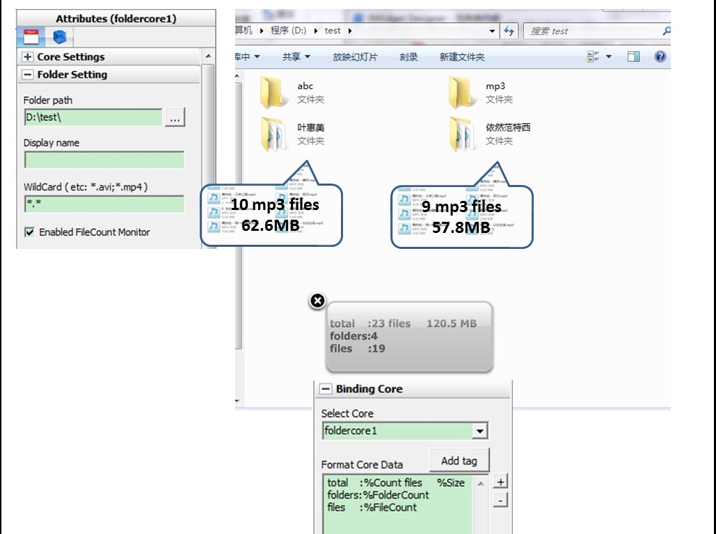

PostPosted: September 11th, 2012, 8:15 am
Posts: 313

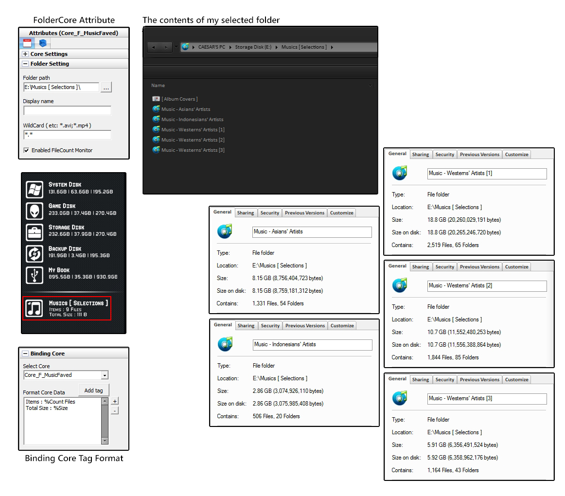

PostPosted: September 11th, 2012, 4:42 pm
Joined: September 11th, 2012, 12:22 am
Posts: 6
Location: Indonesia
Hi qiancang, your parameter's settings are very much similar to mine (except the folder destination of course).
However, the problem's still exist.
If you look at my attachment (please open it at a new tab, it's quite large in resolution), you'll see that my music folder shortcut widget (the one highlighted with red outline), only counts 9 files with total size of 111Bytes.
But, if you see the contents of my music folder in Windows Explorer, you'll see that it consists of 6 main folders. I took 5 screenshots of each main folders properties (these are the folders which my MP3 files stored in), and you'll see that each folders have plenty sub-folders and lots of files.
Is it possible that the structured of my folders, sub-folders, and files causes the problem? Or is it because the large amount of files consisted?
Do I make any mistake in my FolderCore settings?
Any help would be appreciated!
Thanks!
PostPosted: September 11th, 2012, 6:17 pm
Posts: 313
your FolderCore settings is correct, i can't find the problem in the pic.
what's your XWidget version? Please download and install the lastest version:http://www.xwidget.com/
can you upload your widget ?

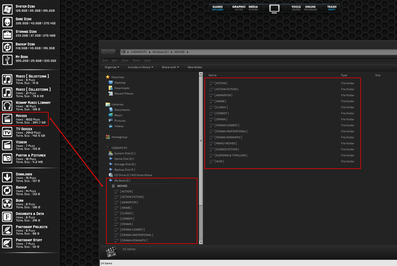

PostPosted: September 13th, 2012, 6:30 am
Posts: 594
caesar666 wrote:
My XWidget version is 1.6.0.710.
Link to my widget : http://www.mediafire.com/download.php?z8zkla0ghtthv92
As an additional info, I'm using Windows 7 Ultimate X64, my PC specs is in my signature.
Thanks!
Hi, Maybe because your folder name include "[ ]" ? Can you test other folder path?
XWidget Software Developer
PostPosted: September 18th, 2012, 6:32 am
Posts: 6
Location: Indonesia
qiancang wrote:
Sorry, caesar666 , I failed to find out the problem.
Your widget worked perfectly in the PC of my friend who uses Windows 7 Ultimate X64 and my pc(Windows 7 Ultimate X86)
Hmm... That's weird, maybe the problem only happens on my PC.
Anyway, thanks for your help Qiancang!
Hi Tony,
I've already thought about the included "[ ]" in my folders' names as the possible cause of my problem.
But there are two main folders containing many sub-folders with "[ ]" in their names, and the FolderCore is able to view the correct file number & total size count.
So, I don't think the "[ ]" in some of my folders' names are the culprit here.
Please see my screenshot attachment below.
Additional info :
- The two correctly viewed main folders are "Movies" & "TV Series" folder located in my external desktop HDD (WD MyBook Essential USB 2.0)
- All other folders are located in various partitions of my internal HDDs (Dual Seagate SATAII 7.200rpm)
File comment: Notes :
- The red rectangle outlines & line is my "Movie" folder which is correctly viewed despite the "[ ]" used in its sub-folders' names
