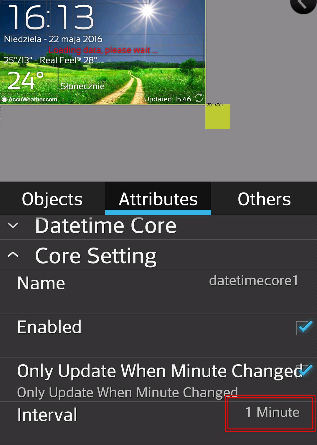

Test in progress.... in my LG G2 with Stock ROM 4.4.2
Error is in @datetimecore1
Look at screen. The default is 30 minutes in the Android !!!
Should be changed to one minute!
1. Option (tap on widget)
2. Edit Widget
3. Others
4. datetimecore1 --> Attributes
5. Core Setting --> Interval = 1 second !!!
6. Only update when minute changed = OFF !!!
Check it this !

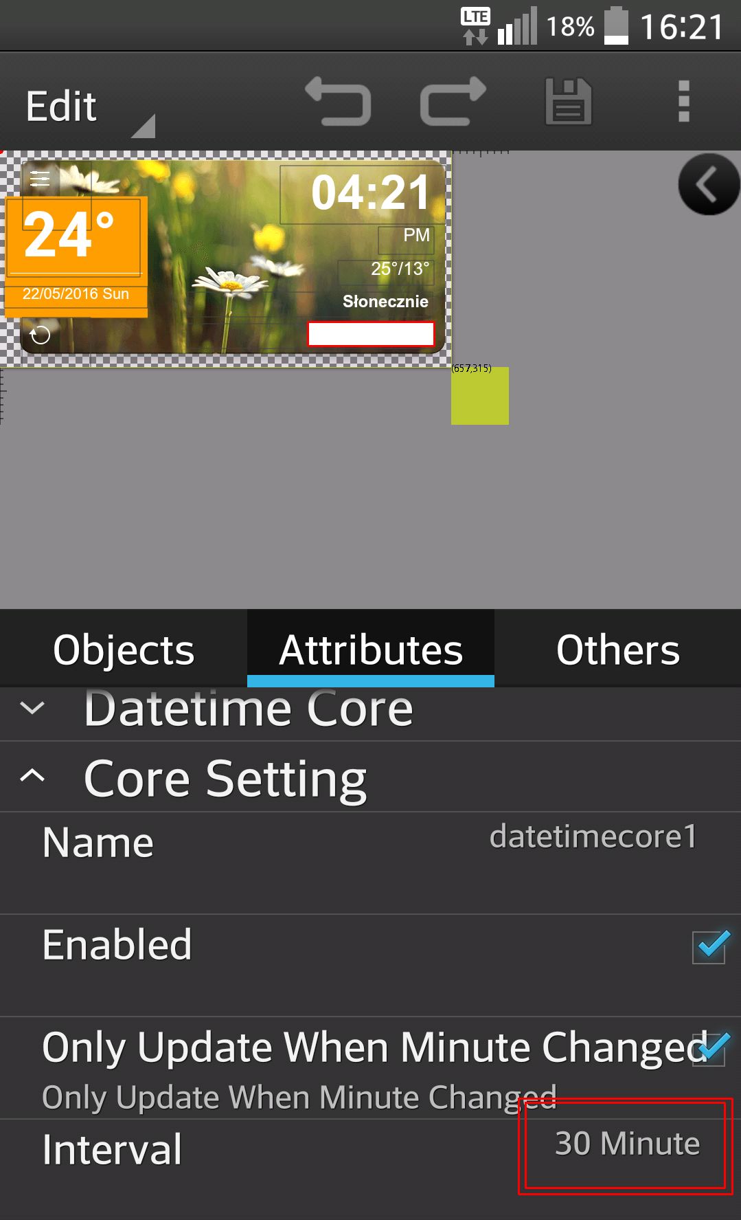

@Jimking
Your widget

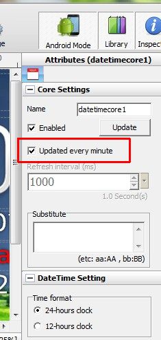

@ datetimecore1
I do not understand how it had come in Interval 30 minutes ??? I am writing here about the editor for Android.
In the PC editor does not have anything like that.

Ok, I think we have confused a bit the two cores..
1) The problem that actually exists is the time freezing, so we need to talk ONLY for the datetimecore.
2) All the clock widgets -> Android version, use as default the "Updated every min".
And this because the widgets not have the second hand! So the core will update when it's necessary, every one min.
If you disable this on Android, then you will be able to use clocks with second hand BUT the ram consumption will increase (also the movement is not so regular)
That's why Tony enabled this by default.
3) I NEVER changed ANYTHING to the datetime core and to be honest I don't know the real meaning of this "Interval" setting since the option before this " Only update when minute changed " is enable!
So, the conclusion.. Since ALL the widgets that have the datetimecore use the DEFAULT values, and these widgets WORK FINE for almost all the OSs except the kitkat, the problem maybe is not there. Because if the issue is caused from this "Interval" setting, NONE of the widgets should work.... (!)
Something is wrong with the KitKat OS that blocks somehow XWidget and don't let it to work properly.
