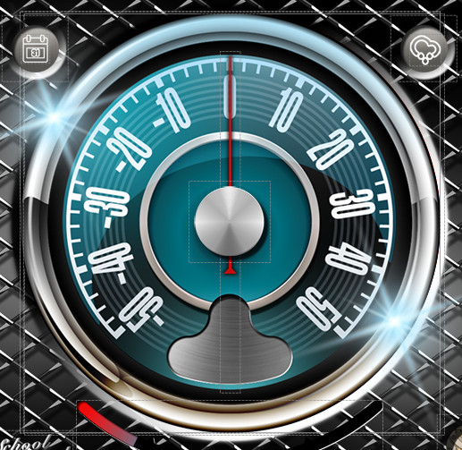

I checked my design and the needle has:
StartAngle: -135
EndAngle: 270
Temperature in C.
I have two face "clock" images with both temp units F and C..
The fact is that I already have 121 images with the movement of the needle. I tried to select some of them to match with the above values, but is not accurate at all..

ok, now i found what you mean,
your images are not match with the original image,
you should adjust them based on bg image, since the bg's range is not accurate
maybe my example widget can be helpful on choosing which one match the bg,
change the binding tag with numbers to find out which one match
you can specially test it with "redarrow_30.png", and you will see the difference between bg's 30degree
or we can use script code instead

Yes I mean your example.. At the test widget that you send me, add a right click option to change location and make some tests.
For the high temps the needle goes "out"..
If you can do it though script with the angle values that I wrote you...

Posts: 362
it's ready:
Notes:
1. the script automatically detects both C and F,
2. if you want the old values before update, but don't want text object, you can invisible the text object
after you have done designing, send it to me to optimize the code if needed

Here is the final version. ALL WORK OK! Check the right click options and the on top buttons! :)
(I had to make a little trick to combine both C and F panels. Since the text object that has the "OnChange" tag and the "rotator" must be twice, one for temp in C and one for F, I added a second core and I copied the scipt changing the text1->2 and rotator1->2)..
viewtopic.php?f=11&t=5015

ok, it's ready:
old_school_dashboard [test] [2014.09.16]1523.xwp [4.47 KiB]
Downloaded 528 times
Notes:
1. you should add deleted images&fonts to widget
2. you should adjust the objects' position if they needed
Changes:
1. Added: Saveini and menuitem checking for menuitems
2. fixed: location changing by removing one of the accuweathercores and changed the code to work only with one
3. fixed: celcius/fahrenheit changing by changing the textonchange function in the code
4. fixed: slidepanels to not get in the behind of another; now when you slide one, other one will slide-back
5. changed: position of [time] and [date] objects to [timee] object in the widget tree; to be compatible with changing clock mode and saveini; (also i have adjusted the position of them in new place; check the position of them to be adjusted)

i have created an alternate version,
maybe i don't wanna end up the work :D
i created this because i couldn't decide which way will be better,
so i decide to made both of them,
this one will change C/F itself without effecting the core's unit,
the difference from previous version can be seen here:
1. you can change the unit and see in that unit in the accuweathercore weather info dialog, without effecting main text&rotator, (but it will effect on Weather-Slidepanel)
2. you can see the Weather-Slidepanel in the unit that choose in accuweathercore, so the unit doesn't change when change between clock/celsius/fahrenheit
in previous version these are this way:
1. you could only change weathercore unit and see it in the wether info dialog when you're using clock mode
2. Weather-Slidepanel would be shown in the unit of last layer mode that you have used in the widget
