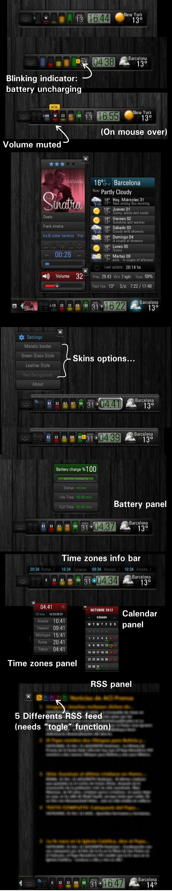

Here are some screenshots of previous BETA VERSION I'm working on new screenshots ...

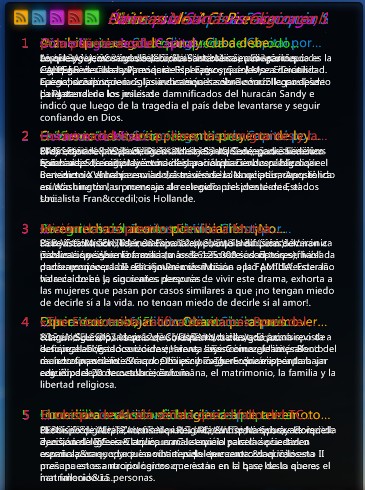

PostPosted: November 8th, 2012, 5:44 am
Posts: 313
3 bugs
  • the rss could not auto hide one column when another appears.

qiancang wrote:
[*]the rss could not auto hide one column when another appears.
[*]these settings will lose if you refresh the widget.
[*]wmplayer is not closed with the widget close.[/list]
Thanks again for your feedback!!! I am improving some things.
"the rss could not auto hide one column when another appears"
Yes... I don't know how to write the code to do "toggle" between the different panels... I'm just a designer...
"these settings will lose if you refresh the widget."
The same to this. I don't know how to do...
"wmplayer is not closed with the widget close"
I prefer it that way. I do not know what people prefer.

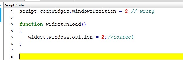

PostPosted: November 17th, 2012, 5:48 am
Posts: 313
Armando wrote:
I Found the problem!!
I delete this script: script codewidget.WindowZPosition = 2
And now toggle works... Why????
Seams like it's a bug in the xwdesinger... Could be?[/size][/b]
Your code is wrong... You could not write it in this way
"widget.WindowZPosition = 2" must be written in widgetOnLoad function.
